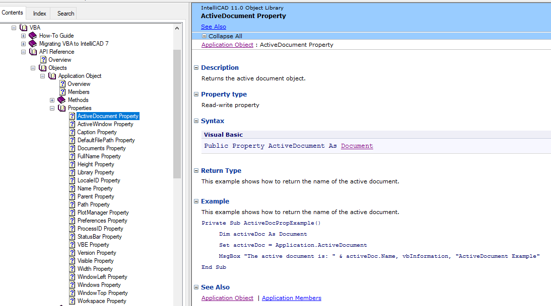

What is the difference between ThisDocument & ActiveDocument, i'm unable to find anything in the Icad help files.

#53
Hi Steven,
The ActiveDocument is the IntelliCAD active document object.
The ThisDocument means the same as in the past but didn't use in the current version.
(unlucky, some sample codes in official documents still use the ThisDocument, so it causes the confused for users.)
