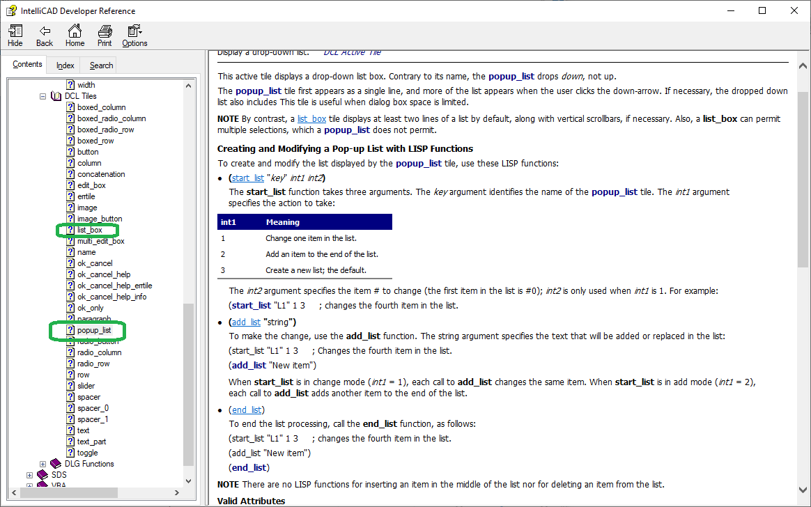

Does anyone know if it is possible to create a DCL dialog (single) that is populated with different options dependant on a selection choice.
EG: 4 columns.
Column 1 has 5 options a, b, c, d & e
Column 2 will display options a1, a2, a3 & a4 if option 'a' s selected in column 1
Column 2 will display options b1, b2, b3 & b4 if option 'b' s selected in column 1
etc
etc
Column 3 will display options a11, a12, a13 & a14 if option 'a1' s selected in column 2
Column 3 will display options b11, b12, b13 & b14 if option 'b1' s selected in column 2
etc
etc
