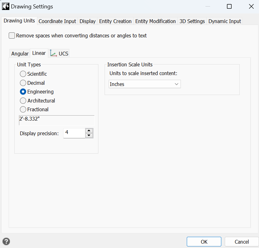

I'm having trouble with the GEO command working at the correct scale. My Units are set to engineering (base unit inch). When I run the GEO command, the Map inserts at 1/12 scale. eg 1 map unit = 1 foot.
I've tried changing the insertion scale (undefined, inches, feet, international survey feet) on the UNITS command, but that doesn't seem to make any different to the GEO command. I've tried a bunch of different coordinate systems, but there isn't an "inch" coordinate system to my knowledge. Using a meter coordinate system rather than a foot version, makes it even worse.

I'm not seeing this Format>Drawing units command.

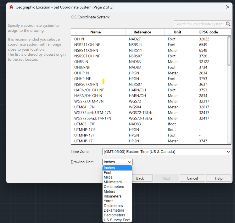

I will also note that the AutoCAD GEO command offers a drawing unit drop down that handles this from the Coordinate system selection screen.
This interface option seems to be missing from the Intelicad command structure

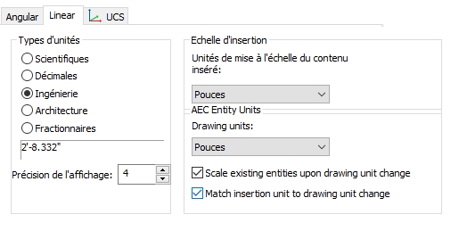

Make a second dwg but with imperial units (Format menu > drawing unit engineery units and insertion scale to inch.
and check the box : match insertion units to drawing unit change
Insert your first dwg file as External reference in your second dwg file (insertion > External references).
