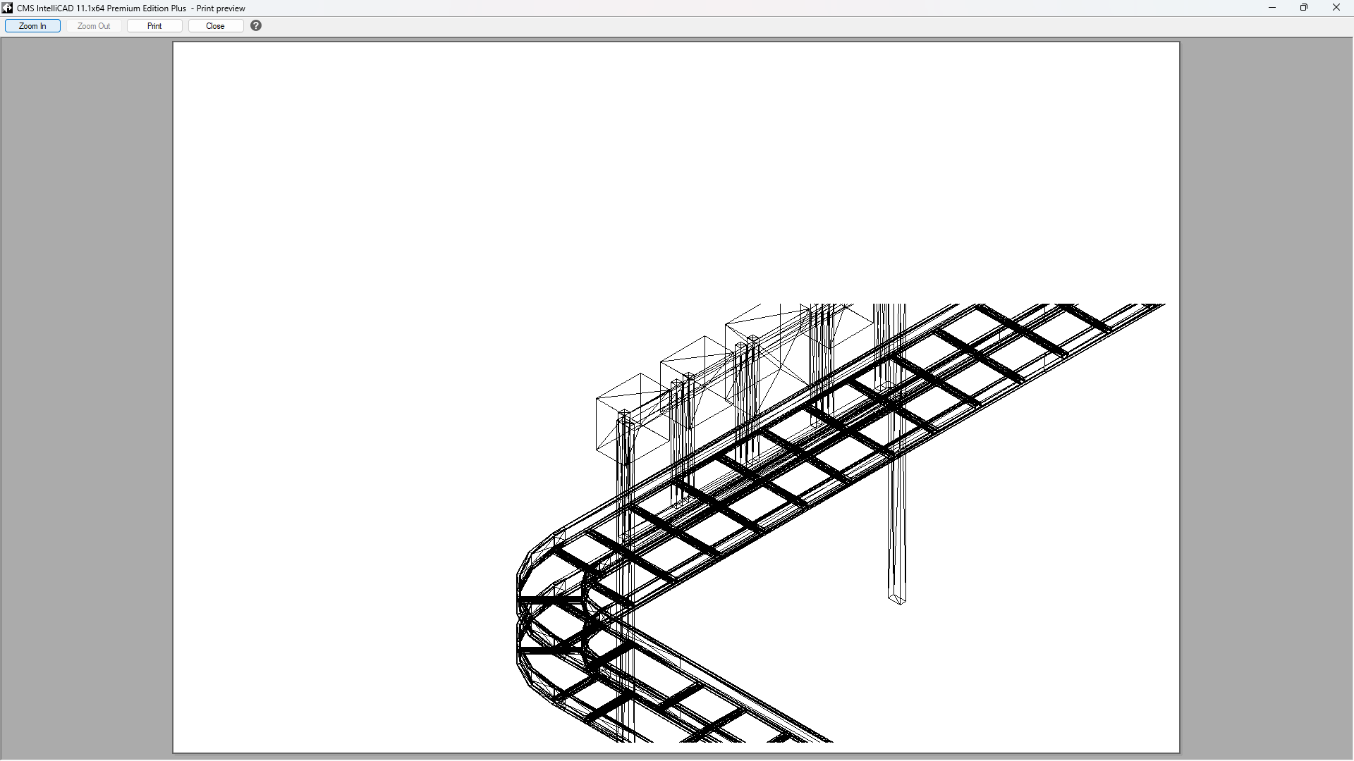

#2I assume you have: Build no. 11.1.435.145443?
When you go to print preview do you see the 'zoom in' & 'zoom out' buttons top left?
- zoon in out.png (103.97 KiB) Viewed 8484 times

#6The zoom-in/out works as usual in build no. 11.1.435.145443.
Please check the printer driver.
(try to use the printer: DWG to PDF.pc3)
