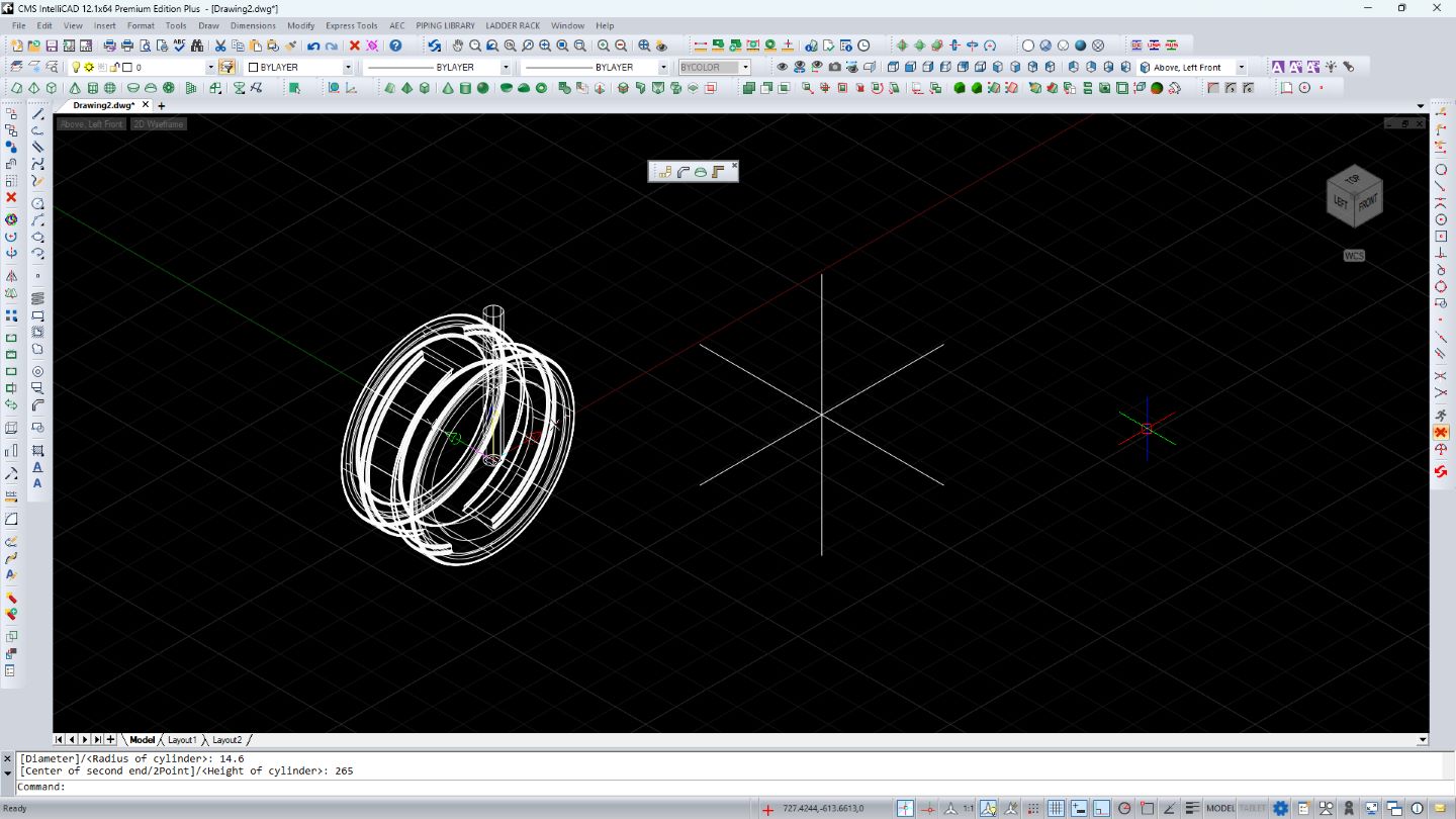

Re: Changes to 12.1 causes issues with relative/absolute inputs.
Here is another example:
Create a cylinder of radius 14.6 and a height of 265 at WCS origin
code:
(command "_cylinder" "0,0,0" (* 0.1 FTF#) (rtos  OBORE#))
FTF# = 146
OBORE# = 265
result:
Command: _cylinder
[Elliptical]/<Center of base of cylinder> <0,0,0>: 0,0,0
[Diameter]/<Radius of cylinder>: 14.6
[Center of second end/2Point]/<Height of cylinder>: 265
Command: '_PMTHIST
Command: LI
------------------------ 3DSOLID ----------------------------------
Handle: 5D1
Current space: Model space
Layer: 0
Color: BYLAYER
Linetype: BYLAYER
Line weight: BYLAYER
History: Record
Show History: No
Bounding Box:
Lower Bound: X = -14.6 Y = -14.6 Z = 0
Upper Bound: X = 14.6 Y = 14.6 Z = 265
