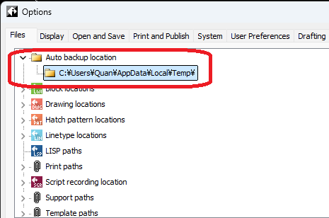

Microsoft did an update last night and all the work I did in Intellicad is gone. I know autocad had backups. are there backup in intellicad and where do I find them?

Hi Petter,
The backup file location (if existing) is in the Option Setting as shown in the image below.
Good luck!
