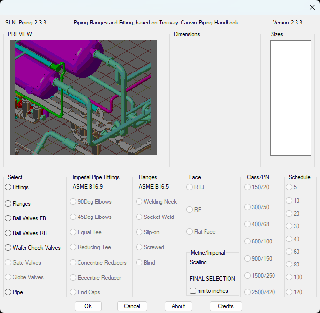

Here is the latest files for Revision 2.3.3 ---- UPDATED FOR ICAD VERSION 13.0
Completed dialog.png (70.46 KiB) Viewed 35351 times
Dim Files
https://www.dropbox.com/scl/fi/ug06g5q9 ... pzqi6&dl=0
Piping part 1
https://www.dropbox.com/scl/fi/f5xtvbhj ... 1rq4l&dl=0
Piping part 2
https://www.dropbox.com/scl/fi/do2tf50j ... k39kv&dl=0
Instructions PDF
https://www.dropbox.com/scl/fi/jwfndwmz ... afom0&dl=0
As usual, all previous links removed.
