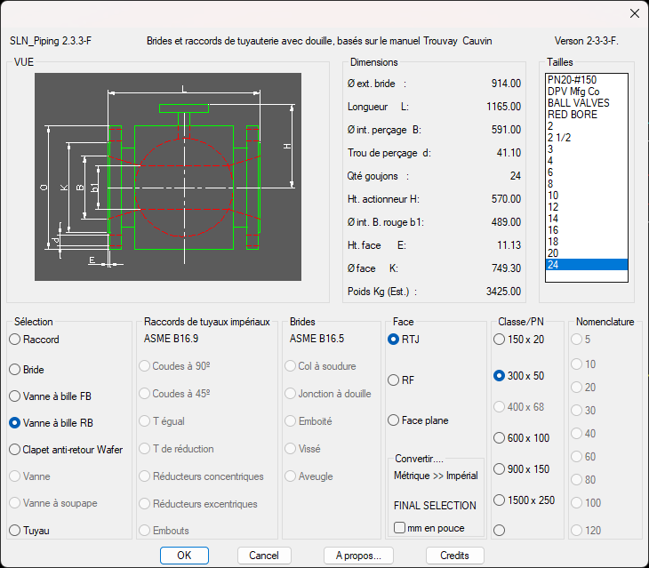

Re: 3D Piping Menu - FRENCH
Here is the latest files for Revision 2.3.3 ---- UPDATED FOR ICAD VERSION 13.0 - with FRENCH user interface.
french menu 2-3-3.png (59.87 KiB) Viewed 165920 times
