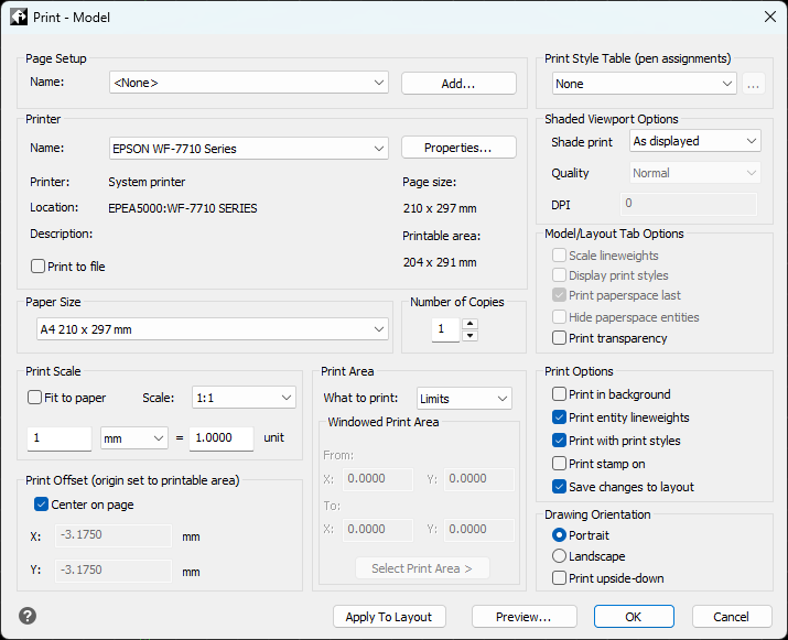

Just to add to above.
I have just created a new drawing, set the limits to 0,0:210,297 (A4)
Placed a 100,150 rectangle in the center of the limits/page
then printed,
When printed & measured, by eye/rule, the rectangle is 100,150
print settings:
- 1-1 printing.png (50.75 KiB) Viewed 5380 times
