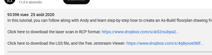

Steve look at the info menu of the video there are a dropbox download link !
BUT when you have unzipped the .rcp, place the Stewart_House.rcp file in the support folder.
Then open IntelliCAD and Insert/attach the Stewart_House.rcp file as underlay.

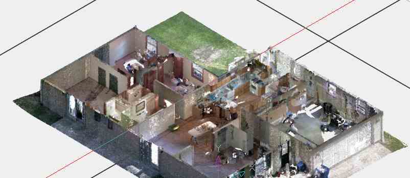

I can use point cloud file but there are no tools to make cut or section in IntelliCAD now.....Sniff!
EDIT: Sorry! section plan from 3D rubban work ! Very good!
I choosen the orthographic cut with Top option and because the zero Z was on 2.2 meter/ground high I obtain this section !
I choosen the wire style for the windows and of'course OpenGL ES mode. It's the best because the display lag sometime.

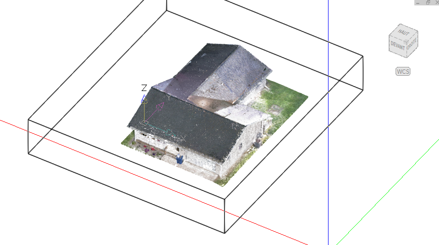

Place the Stewart_House RCP.zip in a documents folder.
unzip it
You obtain : Stewart_House Support folder + Stewart_House.rcp file
Place this Stewart_House.rcp file in the Stewart_House Support folder
Open IntelliCAD create a new file and save it near your . Stewart_House Support folder
In the menu "Import" go to "Attach a point cloud" and go to your . Stewart_House Support folder and choose the Stewart_House.rcp.
Wait some minutes to load the big file and Voilà!
Choose the Opengl GE mode and Wire style to the 3D windows and place the view in axonometry to see the whole object !
