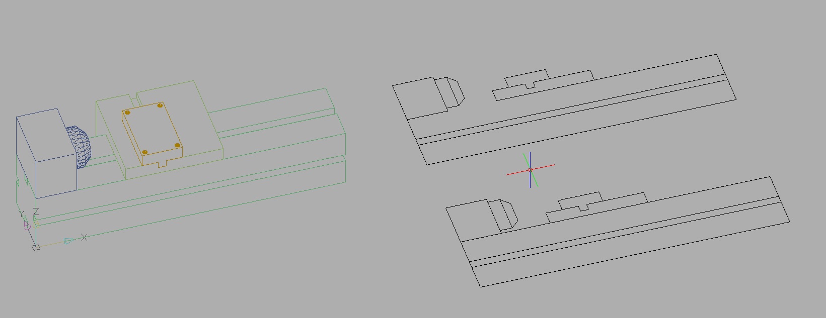

Thanks for the reply. I'd say it's something graphics related but not from the system? I've knocked up a little test and from this image you can see I have two lots of parts. One I have added fillets too etc, the other not. I then did a flatshot of them with the upright end pad in place. It has missing curves.
I then moved the upright pad from one of the parts and did another flatshot, it then shows the curves.
I changed my graphics from advanced to basic for this, and testing more I get the same results in all graphics set ups. I downloaded 4mcad to test that, the same thing happens.....

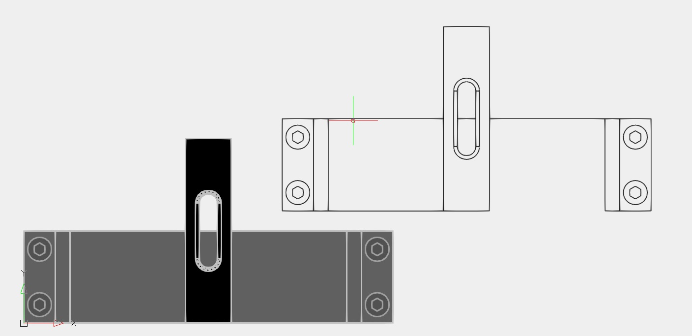

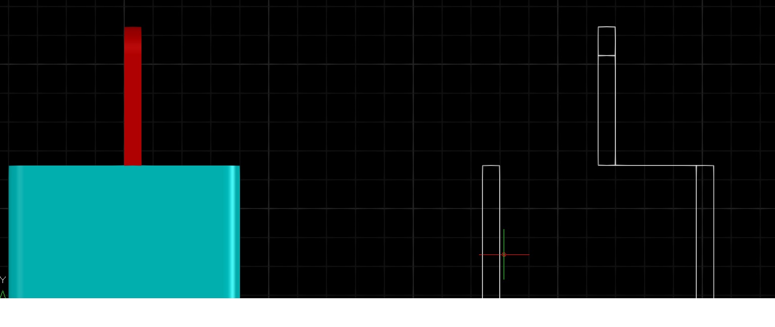

A very basic model I put together to try out certain things, seeing the same problem. If I tip the 3d model space view a tiny amount from the plan top view, the missing edge shows up. Tip it further and it disappears again.
This time I've reinstalled the software, ran the graphics benchmark so it all shows up in the options and this is what I'm seeing.

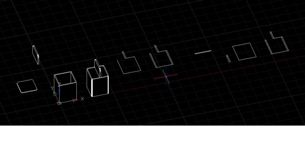

The only thing I've found is some pieces it doesn't like. It doesn't seem to follow too much of a pattern. On the attached file I have a bunch of solids and an imported WDS part. Very random model, but as I say I'm trying to find the problem. I have a model in there which when as a full solid everything work fine. I can shell it, or subtract a solid from it to make a piece of SHS. Still seems to be fine. Put inside that SHS a square piece and it breaks. Just seems a bit wild to me that something so small would cause this. Now yes I could just edit the flatshot block, but if this was anymore complex then it wouldn't be so simple to do so.

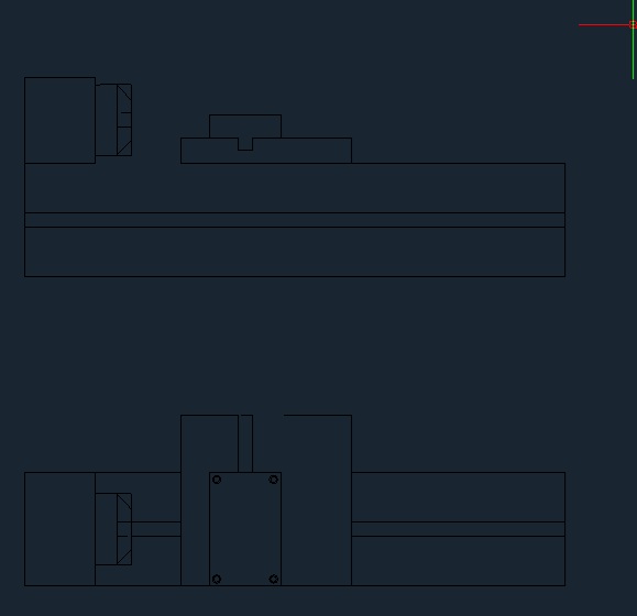

In my quest to find out what is happening with this I'm trying various other providers of this type of software. All of it seems to behave the same. I have come across something called BiiCADo. This seems to be not supported anymore since the website is kind of stale and out of date. You can still download a trial, so I did. The flat shot works perfectly fine. Exactly the same file that fails in Intellicad, works fine in that sofwre. Because of this I figured it can't be my graphics set up or anything, so what is happening?
