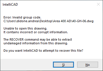

#6I've similar problem, icad 9.1 hangs during save and file is corrupted
I've also disabled autosave because it corrupted my file.
the file format is setted to "autocad 2004", how to set "partial saving"?

#7after upgrading manually (*) intel rapid storage and intel management engine no more corrupted saved file since 10 days
(*) manually means not using windows update, but looking for driver in intel website and add it manually, forcing installation
Re: Unable to RECOVER this drawing
#8bad news, this morning it has hanged again during saving
however, saved file seems ok
