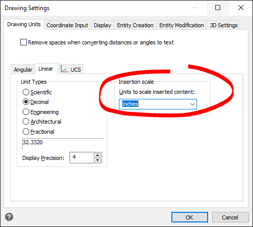

Q: What does 1 unit represent in CMS IntelliCAD?
A: 1 unit in CMS IntelliCAD can be scaled to inches, feet, miles, millimeters meters, centimeters, etc. Such definition can be set at UNITS command > Linear tab > Insertion scale.
