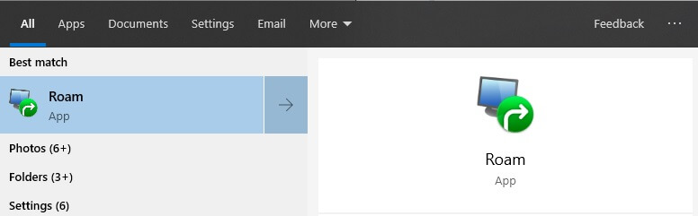

  • Go to Microsoft Windows® desktop Start and browse for the CMS programs folder > click Roam application;
optionally, search for “ROAM” at Windows® search and click ENTER;

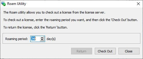

  • Enter the number of days planned for offline use, and click “Check out”;

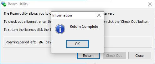

  • When returning the seat to the licensed LAN, connect the client system to the LAN network, run step 2 again. Then click “Return”;
