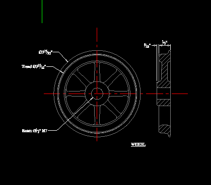

hi Patrick, I will attach a 2D of what I am trying to draw in 3D. so you get the idea. I have tried to draw a 1/4 section and copy and join but either you cannot join OR if you do it will not fillet.

Something like this?
(just thrown together ignoring real dims)

Hi, EXACTLY like that .......so.....
1) Is that now a one piece solid? ie could it be converted to an .stl file for 3D printing?
2) HOW THE Fiddly deee.... did you do it.....I have been at it all day and still can only get a maximum of 2 spokes to fillet at the hub. If I try to mirror the solid (ie four quadrants as solids and join ) then I cannot join them.
Any chance of a video perhaps please?
Brilliant. :D

Oh poo, I didn't save the file, sorry.
Basic sequence was create outer rim profile as a 2D polyline shape, then revolve around the centre line axis.
Fillet the route where the outer lip meets the main part of the rim, then fillet the outer lip at the max diameter.
Create the inner hub with hole for shaft.
Create a 'spoke' and Union it to the inner hub and outer rim.
Then fillet between the spoke & inner hub, followed by fillet between spoke and outer rim.
NOTE: only one fillet at a time.
So you should have one spoke and the inner hub and outer rim as a single object.
I then used polar array (set UCS as required) specifying 360 deg and 6 items.
Tada!!!!
