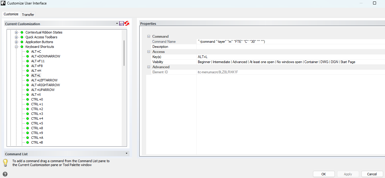

Here's another option:
In CUI add a keyboard shortcut ( ALT+L )
open the new shortcut
Then under Command Name add
 ^-(command "-layer" "m" "FTE" "C" "30" "" "")
This does not contain the cancels ^C, I would add them if there is a chance of using this macro when another command is active.

by MARTIN L
THANK YOU SO MUCH !! IT WORKS !! :D
