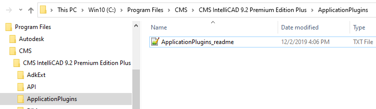

#2Please refer the document from the document API.
When IntelliCAD is installed, a directory named 'ApplicationPlugins' will be created on the same level as the icad.exe executable file. A new directory under this one MUST be created with a unique name. Perhaps the directory name could be your company name, or even just the name of the app it stores, but your application(s) MUST be in a subdirectory under the 'ApplicationPlugins' director.
In addition to your application(s), your unique directory must contain a file named
'PackageContents.xml'. This file has content simalar to the following:

- IntelliCAD_ApplicationPlugins.png (12.84 KiB) Viewed 7096 times
