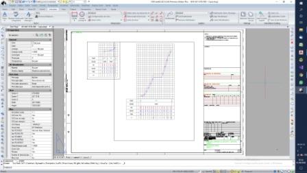

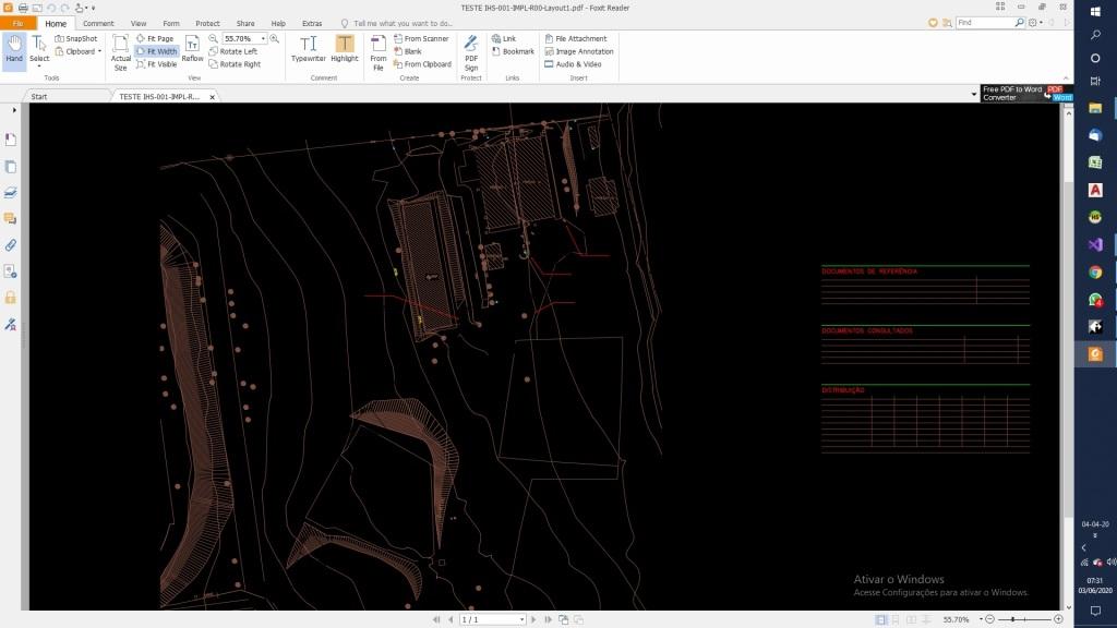

#6The Page Setup is ok, I tried to use DWG to PDF.
The result is a black drawing in PDF file.
Other formats the result is a PLT file. In "Microsoft to PDF" the page size max is A4, and result file is also PLT.
Did I miss something ?
Version 9.2.
Version 9.2.

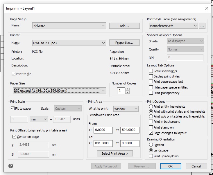

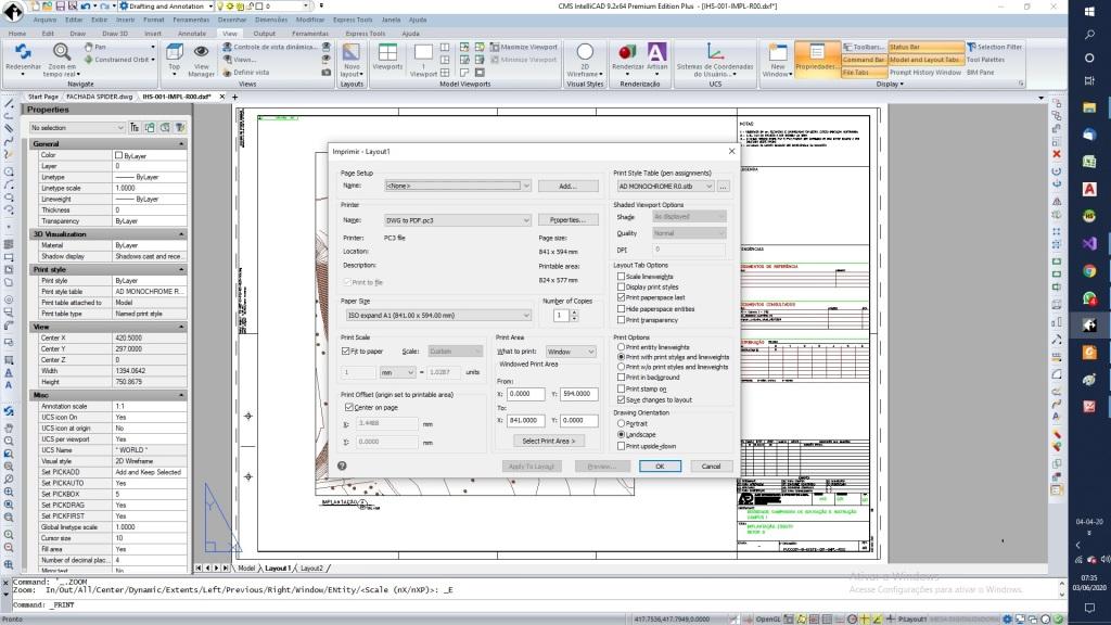

I'll try reinstall one of them. But "Dwg to Pdf" can't be reinstalled.
I use .stb file and I tried to change color of background and also table colors turn white and black to see if results change. I doesn't.
File to print Result Config screen:
- cms8.jpg (101.87 KiB) Viewed 37714 times
