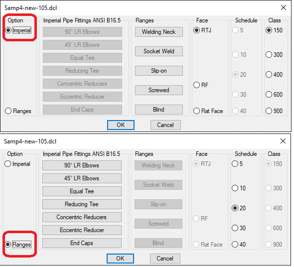

Re: Radio Button Cluster Tile
I have been away from this project for a few weeks due to work, but back on it now and I have a new problem.
I have attached the lsp & dcl files.
How I was intending this part to work:
The dialogue give the user a choice of fittings or flanges, the user selects which option they want.
From their initial selection the remaining buttons are switched on/off as appropriate to leave the user with only those options that are relevant.
So selecting any flange option will turn off all of the fittings buttons and turn on the radio buttons for 'face' / 'schedule' / 'class'.
Or selecting any fitting turns the 'flange' buttons off and turns on the 'schedule' radio button.
In this way the user can not make an inappropriate selection. This appears to work as intended :)

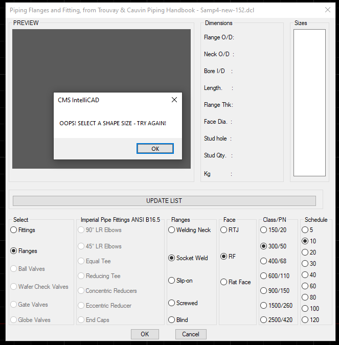

This is how the dialogue currently stands,
Any comments appreciated.
One question regarding the DCL, how can I evenly space the buttons in the FACE column?
But now onto the part I've been putting off, using the contents of my variable 'fname' to populate the list box
I'm making slow progress, but I have not been able to resolve this one problem.
Passing the value of variable 'fname' to the following code.
  ;Find and open data file, *.dim
(defun OPEN_DIM_FILE ()
;    (setq DIM_FILE (open (findfile fname) "r"))
	(setq DIM_FILE (open (findfile "WN_RF_SCH_5_#150.DIM") "r"))
;	(setq DIM_FILE (open (findfile "wn_rf_sch_20_#300_.dim") "r"))  	;need variable 'fname' value here
