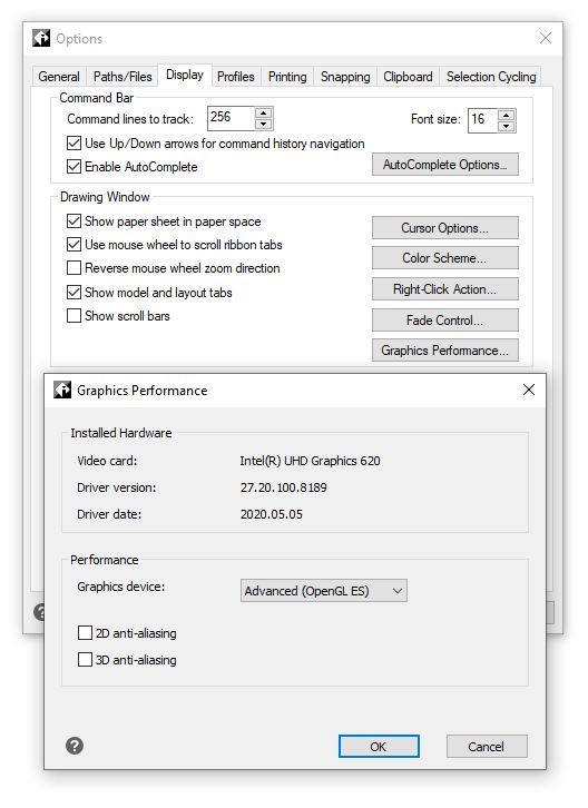

How to tweak CMS IntelliCAD graphics device performance:
1) Go to TOOLS > OPTIONS > Display tab > Graphics performance
2) it's now possible to change the graphics device support from Advanced (OpenGL ES) > intermediate (OpenGL) > Basic (software)
User can also set ON/OFF 2D/3D anti-aliasing.

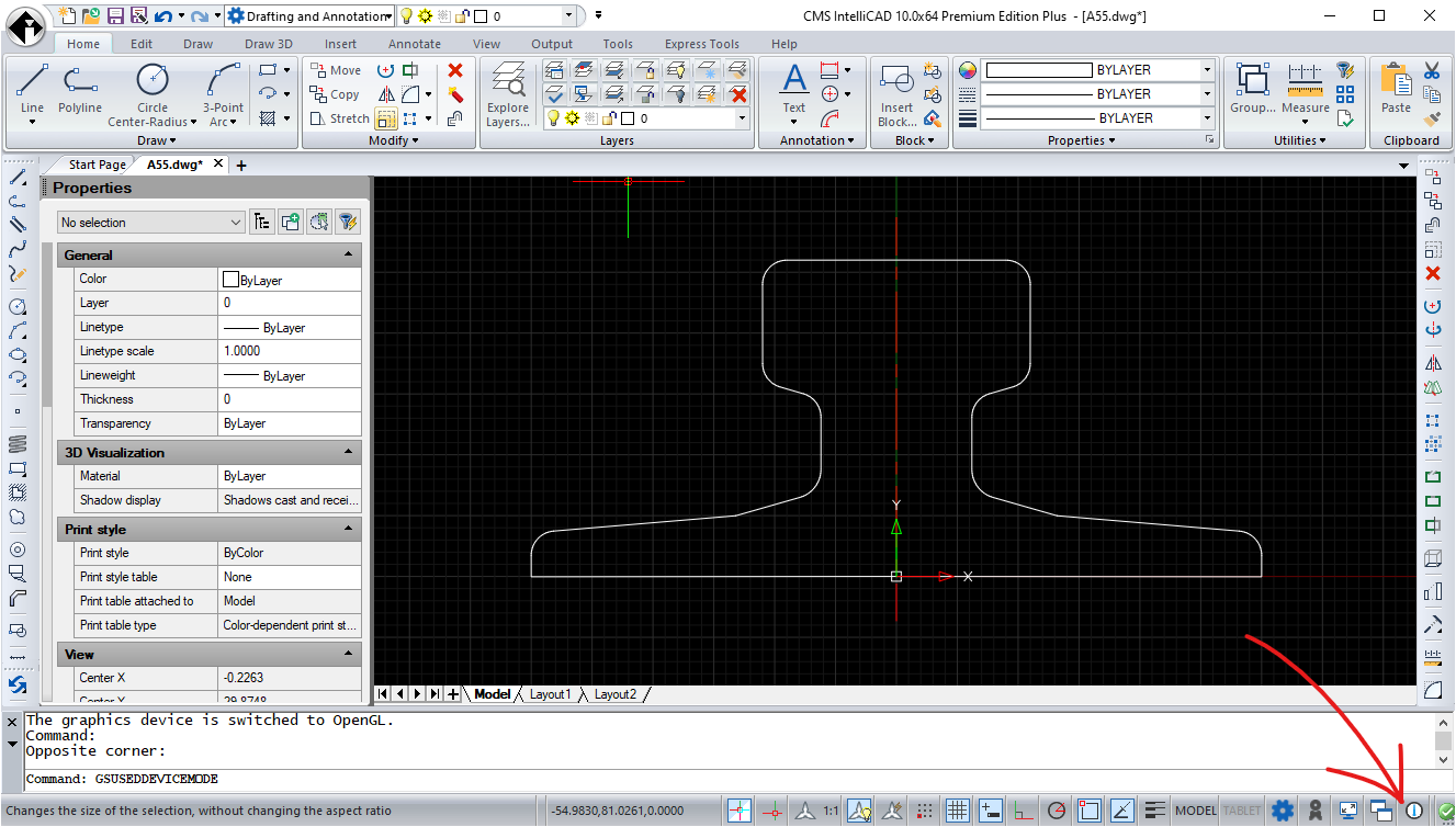

The CMS IntelliCAD graphics device support for OpenGL ES, OpenGL and basic GDI can also be switched using GSUSEDDEVICEMODE (GSDEVICEMODE in v12) command or directly at the CMS IntelliCAD interface as shown below.
Switch graphics device support
