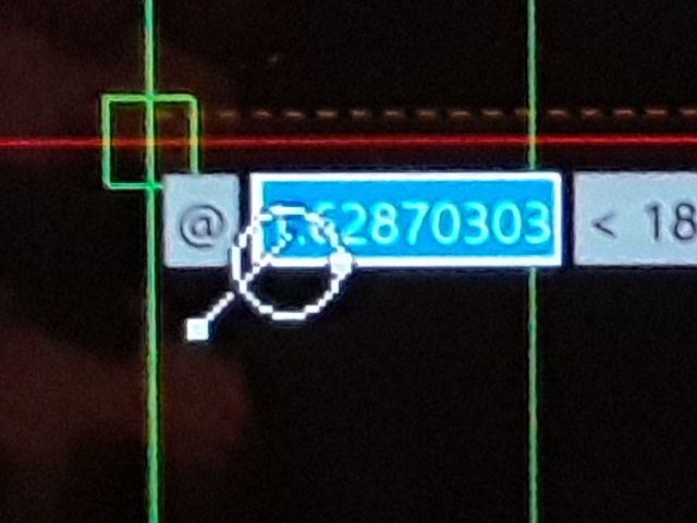

This weird circle with a dot and another line with a dot covers my readout all the time, how can I get rid of it? I can't search for it because I don't know what it's called. I couldn't even make a screenshot of it, it doesn't show up, the same way the cursor won't so I took a pic with my phone.

looks like the snap icons,
End point
and
Nearest
Steve

You're right, it is the osnaps, too bad they float them right over the most important part of the text. If I make the text bigger, it also make the command lines of text bigger and I lose a line or I have to stretch it up and lose more screen space, it's just bad design for a readout.
[Update]
I disabled Flyover Snapping and the white glyphs go away.
