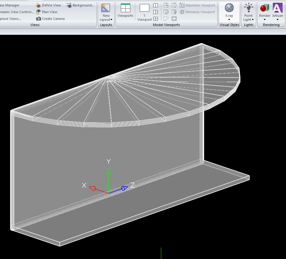

It's very strange, here's on my PC.
(has only one object)
Re: Not opened for read
Posted: Wed Apr 21, 2021 8:57 am
Hi Quan,
Yes only one object, but can you modify the drawing? as this appears to be the OP's problem.
