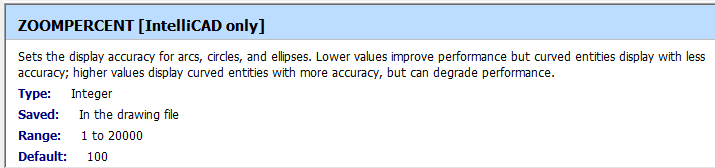

Try to use the system variable "ZoomPercent" instead of.

First of all, the 'ZoomPercent' command doesn't seem to help.
I changed the value to a few large numbers such as 1,100, 20000 and so on, but there is no change.
