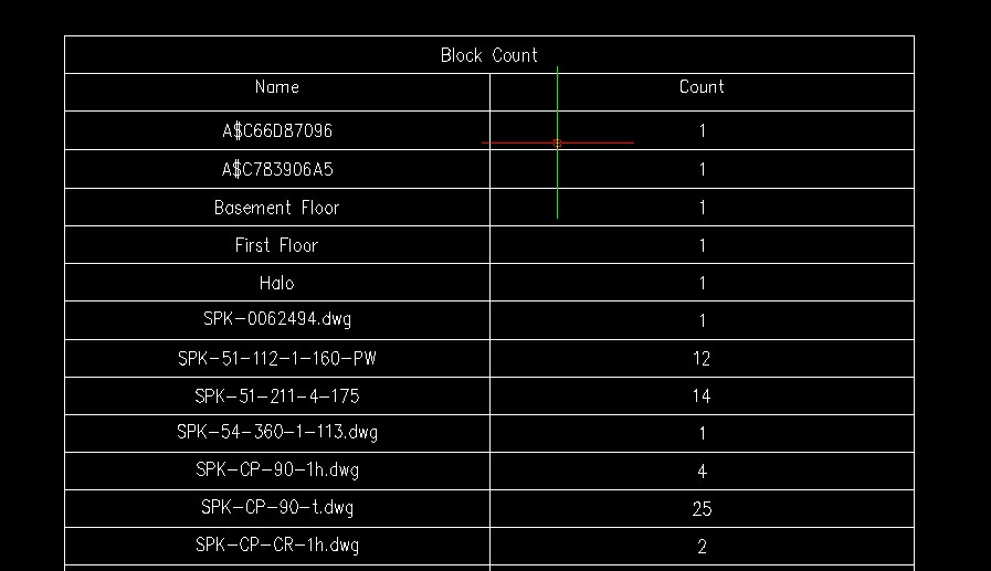

Here's a routine that will insert a table with a block count, not sure if it will work for you
I've attached the .IRX and the source code, the command is blkcount.
just goofing around with the trial and API. looking pretty good these days, better than the SDS days :)
Screenshot blkcount.jpg (64.25 KiB) Viewed 7612 times
Cheers :)
