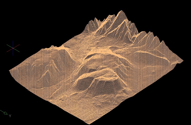

My First IRX routine, maybe useful for someone. I tried to attach it here but, I can't so I put it on my google drive
contains source and binary for 10_1, the command is make tin.

So, I upgraded my version 10 (10.1.1211.127393.PE+.VC16.x64.CMS101a)
and now the routine fails to load.
if I comment out sds_buildlist, and sds_relrb(pFilter) it loads, for some reason sds is not loading in the latest and greatest

changed from sds_buildlist to icedBuildlist and from sds_relrb to icedRelRb and it works again
I uploaded a new build
