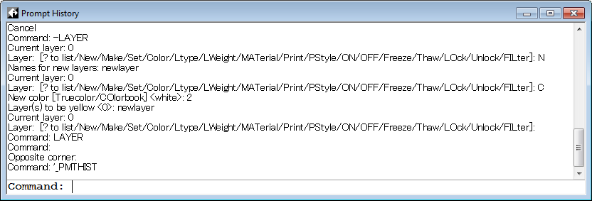

#2Please type the command "-layer" then input the parameters as you like.

#4Ha yes in the history command panel may be.....QuanNguyen wrote: ↑Fri Jan 21, 2022 8:21 amPlease type the command "-layer" then input the parameters as you like.

Mine (french ICAD) is empty : http://sitarchi.free.fr/Download/Image%20002.png
I work on CMS IntelliCAD v10.0.1572.123806.PE.VC15.x64.CMS100a

So now it's clearer! I see all the parameters

#6Yes now all is clear:QuanNguyen wrote: ↑Fri Jan 21, 2022 8:21 amPlease type the command "-layer" then input the parameters as you like.
http://sitarchi.free.fr/Download/Image%20003.png
but why with "-LAYER" and non "_LAYER" please?

#8Thks Steve but on my v10 in french,
-LAYER and _LAYER don't display parameters! Strange not?
but when I change to english lang: I see parameters on command history or commands bar!
See here: http://sitarchi.free.fr/Download/result.jpg
So now I must code in english UI!
