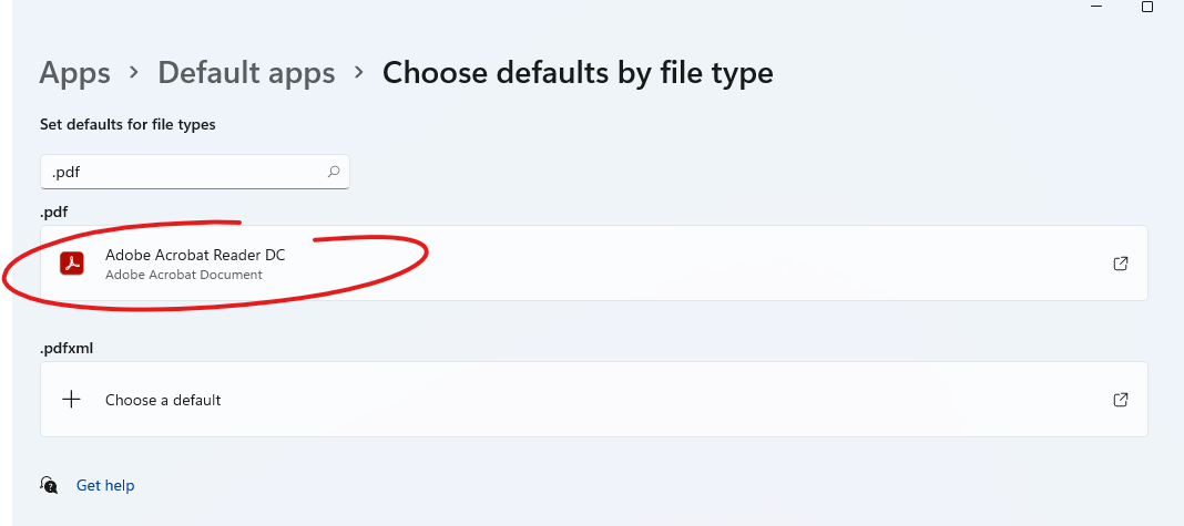

To open web links properly, go to Windows start button > Settings > Apps > Default apps and set https web links to open with Microsoft Edge.
Sem applies to .PDF file extension that user can set to open with Microsoft Edge or Adobe Acrobat Reader:
