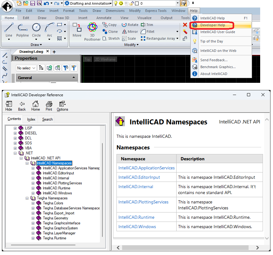

So I suggest using IntelliCAD .NET API to start, it allows you to automate tasks such as creating and modifying objects stored in the database of a drawing file or changing the contents of a customization file. With the inheritance of the UserControl (Windows Forms/WPF) of Windows .NET Framework, we can be making almost the type of dialog inputting. It also supports importing the DXF file and integrating other Windows-based applications such as LibreOffice, OpenOffice ...
Please refer to the official document here:
IntelliCAD Help.png (109.88 KiB) Viewed 31817 times
