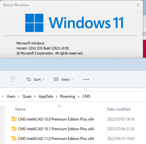

When I go to username/appdata/roaming there is NO CMS folder!
Any idea where it is? as I want to copy over a number of files/folders from my win 10 PC.

#6Well, new PC up and running. Still a few bits and bobs to sort out
APPdata is as it should be, I guess I had not restarted or just user error!
