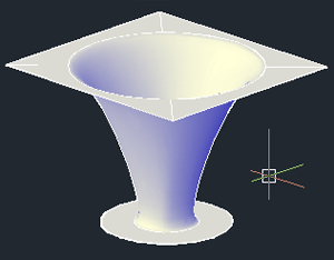

Want to make that in IntelliCAD. How please?

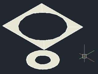

First the top surface was created with the "Rectangle", "Circle" and "Smooth (Loft)" tools. The one below with the "Circle" and "Smooth (Loft)" tools. Make the same drawing on your side to do this exercise with me.
Go to the "Sub-object" function group of the "Home" tab and choose the "Edge" filter. A small blue cube with the upper front edge a little thicker than the others appears near your cursor. This means that you will only select the edges of your objects. Return to the "Surface" tab and click on "Merge". Select the inner edges of the upper surface (4 edges), validate with Enter and then select the inner edge of the lower surface. Press 2x times Enter.

Here is the result of the merge. AutoCAD created a third surface between the other 2 based on the edges of the 2 objects.

use the 'Loft' command
Re: Want to make that in IntelliCAD. How please?
Posted: Mon Jan 16, 2023 12:48 pm
I used it to make the two top and bottom but then I can't use Loft with the result on surface.
It's easy between 2 circles but here top and bottom are merged with the trunk.
It's why I tell my question.... Thks for your reply.

Like this?
Top is a solid rectangle, with a solid disc subtracted.
Bottom is a solid disc with a smaller disc subtracted.
Cone shape is a closed polyline, fillet radii, 'revolved' about the centre axis

Yu're right Steve your proposal answer is interesting but you use the Revolve tool wiyh a face and not the Loft !
But you have created 3DSolid, I havn't try this idea. Thks
