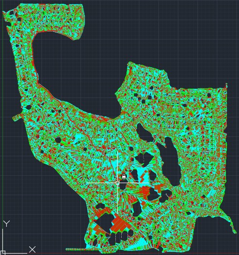

I have an open-source project here, you can have a look at the settings
https://drive.google.com/file/d/1wwZQ-w ... share_link
TSP Solver
Delaunay Solver
Minimum spanning tree solver
A-Star solver
