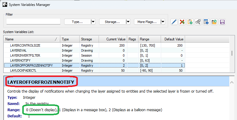

Yes! Thank you Quan!
That worked, I had never heard of that setting before.

QuanNguyen wrote:
Sat Feb 11, 2023 8:19 pm
Hi ,
Please set the system variable LAYEROFFORFROZENNOTIFY = 0 to turn off the dialog box message.
-=(RLH)=-
