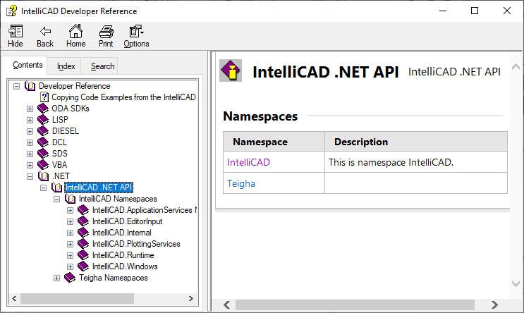

Re: Retrieve the Value from Custom Drawing Properties ACAD->ICAD
Posted: Thu Feb 23, 2023 6:26 pm
I mean the IntelliCAD .NET API, which is included in this software.
IntelliCAD NET API.png (25.56 KiB) Viewed 20467 times
