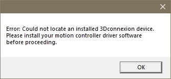

I bought a 3Dconnexion SpacePilot mouse and today I test with it but the 3D space of IntelliCAD can't use these features ? Why please?
I use it with my Blender : No problem and very usefull ! BUT IntelliCAD .....
Is it me that don't know how to use it with IntelliCAD?

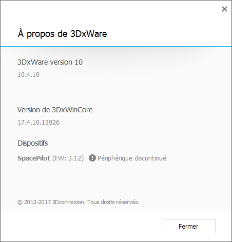

I installed the last Win10 for SpacePilot 10.4.10 but nothing
I installed the last driver 10.8.12 but nothing
I will try the last update driver 3.16.3......

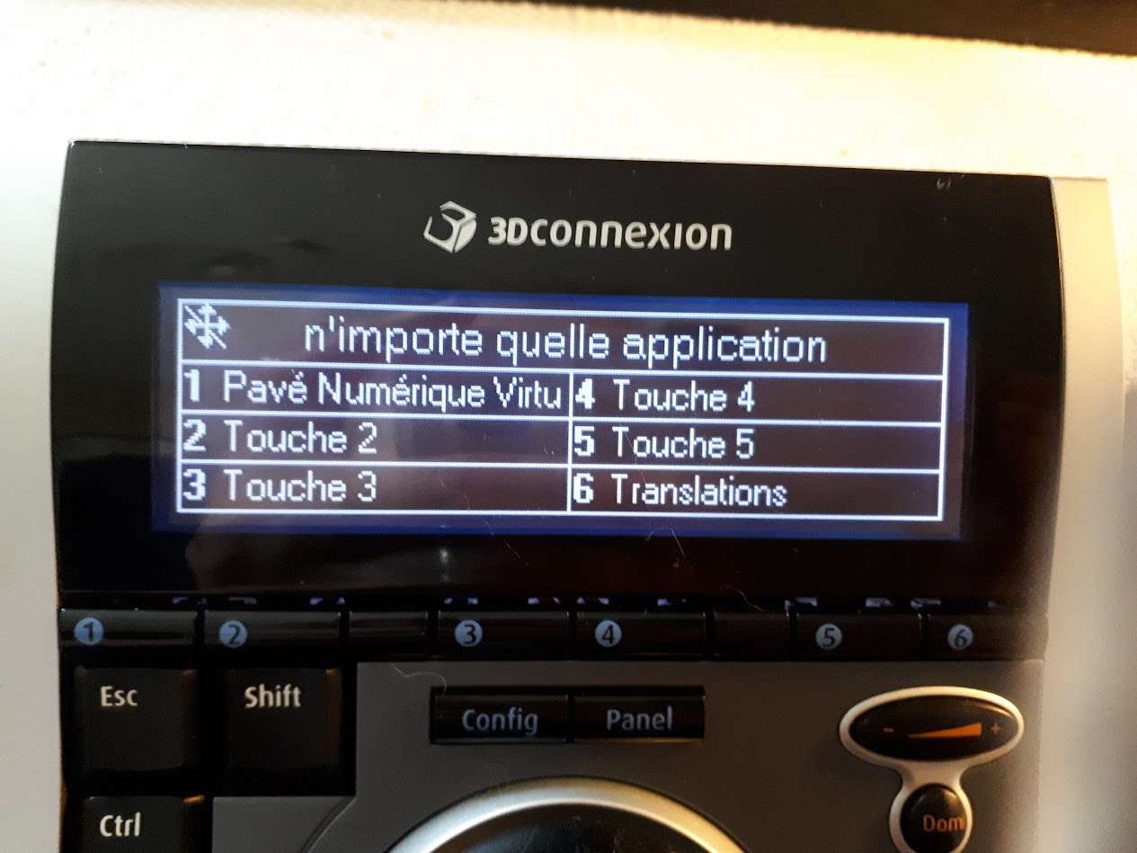

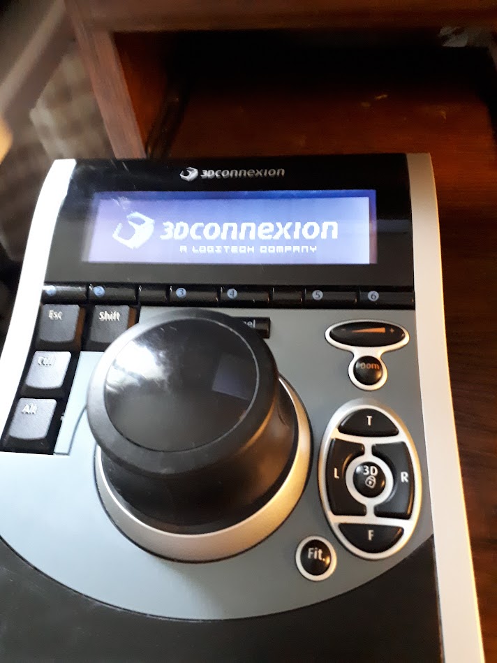

but I think my SpacePilot is broken...I buy it on Ebay 120 euro but I will return it:
when I connect it to the computer, the screen displays "3Dconnexion" but I can't setup the programming keys : nothing !!!!
I tested the 10.4.7 driver for SpacePilot but the 3Dconnexion softwares don't find it and display
Weird ! I got screwed.....
It works only with Blender, not with SketchUp and IntelliCAD....

The 3DConnexion SpacePilot USB Logitech is a used product (2005) and his driver is v10.4.10.
Today the 3DConnexion version is v10.4.12 but don't work with my SpacePilot

it's because the driver was changed totally after 2019 with the v10.4.12. So I can't use SpacePilot avec IntelliCAD.
