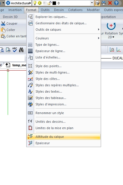

Morniong Steve,
I think it's in the Main menu > Format > height of the layer
In french Altitude is better as Height
_

Hi Pat,
Thanks, but that is NOT it.
I did try, but it has no impact on the sction plane height.

Hi Steven,
Not sure what you mean about the "Section Plane", but after setting the ELEVATION as Patrick suggested, the default elevation of the new polyline will be on this elevation, the same as the Plane (0, 0, elevation).
