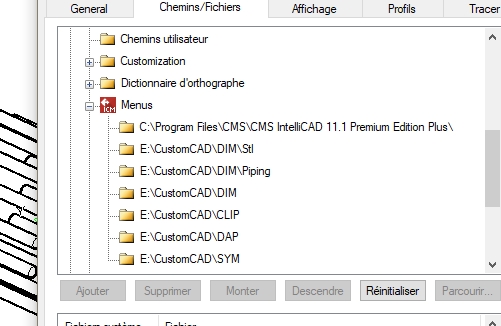

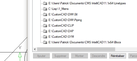

I just have the same error with old plugins.
In Options > Paths
I add my CLIP and DIM files in Support > Menu
because in Support > customization don't work
Then I close the Options and re-open to see in Search paths (read only) if my new path are visible.
