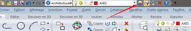

Question 1 : What is this drop-down menu <QuickAccessToolbarControl UID="rbnctrl-color-qat"/>
Is it this menu?

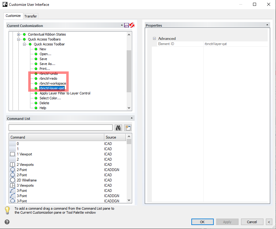

Question 2 : Do you try to use only the palette Tools > Customize the use UI ? Instead of opening the .cui file!
Patrick
EDIT:
Your choice of rbnctrl-color-qat don't work for me : I mean this is a macro menu.

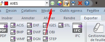

I tried this ; The "Select the color" menu ?
Re: Quick Access Toolbar modification
Thank you very much!
I added the "Select the color" button and it works, however, I am accustomed to the dropdown list. Moreover, I would also like to add "rbnctrl-linetype" and "rbnctrl-lineweight"...

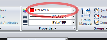

The drop-down menu "rbnctrl-color" is this:
Beneath it are the "rbnctrl-linetype" and "rbnctrl-lineweight" dropdown lists.

I tried to use "Customize UI" but theese entities (as well as "rbnctrl-color", "rbnctrl-linetype" and "rbnctrl-lineweight") are not editable via the "Customize UI" dialog box:
