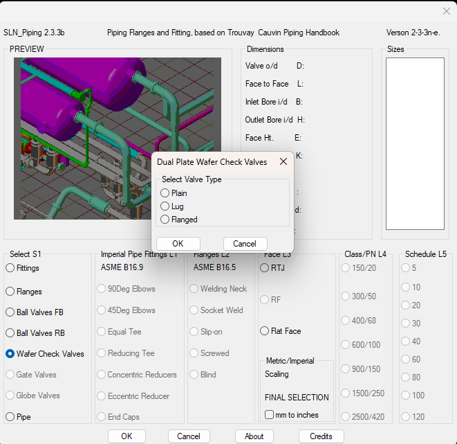

Check Valves
CV dialog.png (104.38 KiB) Viewed 10775 times

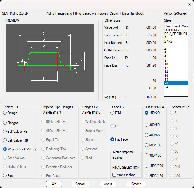

I have progressed the first valve selection, Plain to the point of inserting the completed valve.
CV completed dialog.png (54.3 KiB) Viewed 10775 times
The code behind this works fine as I step through when checking, but when I try this addition in normal use it sometimes works and sometimes doesn't.
