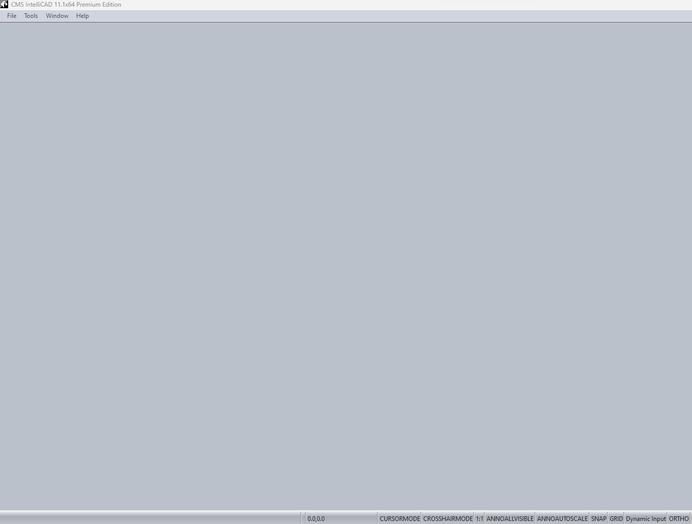

How do I auto start a template file on start up? When I run Icad it opens to a blank home screen and none of my lsp files in the startup suite open ( I get an error saying drawing must be loaded to run). I then have to go to file/open and select a dwt to run.

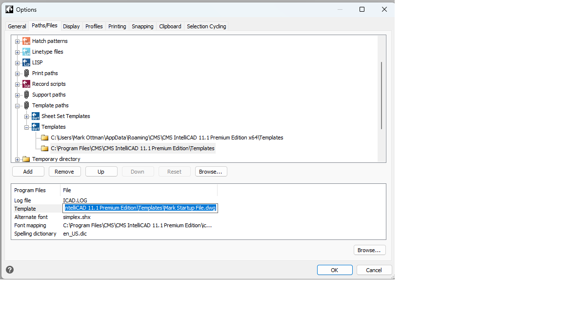

#3Changed the search path but I still get this blank screen
- Untitled.png (36.13 KiB) Viewed 106613 times
- Screenshot 2023-11-14 090918.png (15.38 KiB) Viewed 106613 times

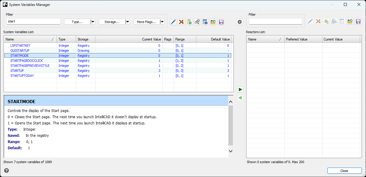

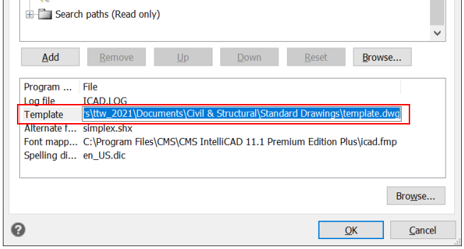

#4There is no option to start a new drawing on startup:
This may help though:
viewtopic.php?p=6823&sid=150162340a6f5d ... fe92#p6823

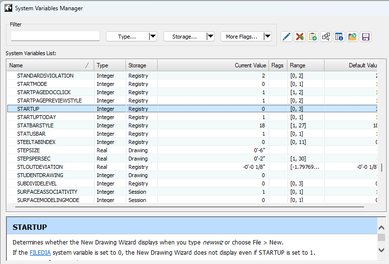

Re: auto load a dwt file on start up
#5partial solution, change the startup value to "0". It will start up as a blank dwg however it still won't load lsp files that are in the startup suite.
- Screenshot 2023-11-15 110434.png (47.14 KiB) Viewed 106596 times
