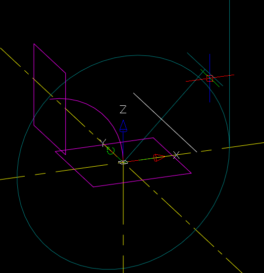

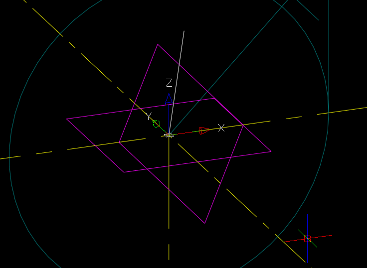

Part of a lisp file I am working on is intended to rotate a rectangle by 90deg about the 'Y' axis.
Sound simple enough.
Here is the code, ENT_L1 is the object & 'rxl' is 225, with 'ag_l' being 90deg
	(command "_Rotate3D" ENT_L1 "" (strcat (rtos rxl) ",0,0") (strcat (rtos rxl) ",500,0") ag_l "")
The result was not as I expected!
OK, so I'll draw a line to represent the rotation axis:
	(command "_Line" (strcat (rtos rxl) ",0,0") (strcat (rtos rxl) ",500,0") "")
and this is the result:
Now I haven't use the '@' symbol so ALL dimensions/coordinates are 'absolute' not 'relative'.
So why does the line state at @0,0,0?

Just for completness here is an image from Icad 12.0 running the same lisp:
line 2.png (26.04 KiB) Viewed 11232 times
The rotation is as expected, thw white line is as expected & the arc (Pline) is again as expected.

The bottom line is that for release 12.1 the behavior for the OSNAPCOORD system variable was redesigned in accordance with AutoCAD.
https://help.autodesk.com/view/ACD/2023 ... F91667F641
You can not disable snaps using the OSMODE system variable, but set the desired value of the OSNAPCOORD system variable.
