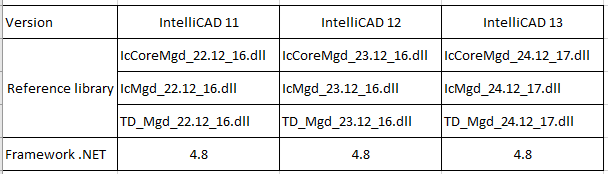

I’m trying to develop an automation using IntelliCAD and .NET. However, even a simple “Hello World” example isn’t working as expected. My DLL loads successfully, but I can’t invoke the method. It seems like I’m missing something minimal.
I tested the same code in AutoCAD, and it works fine. When I try to compile the files using the IntelliCAD SDK, I get the following error: "Can’t get Entry Point function in DLL; Load failed c:\users"
Can anyone help me understand what might be going wrong? I’m using VS Code for development. Below are the .csproj and .cs files.
Do I need to set any specific configuration to use methods via .NET in IntelliCAD after using NETLOAD? Even the ExDraw code doesn’t run on my machine.
