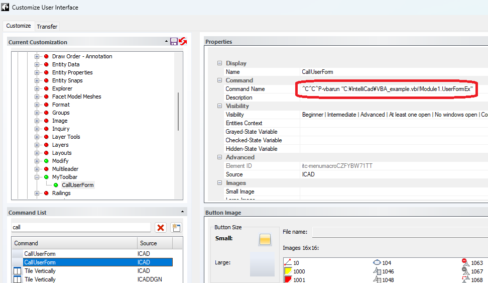

You can create a new button and add it to a toolbar or menu.
The macro for the new button:
C^C^P-vbarun "C:\IntelliCad\VBA_example.vbi!Module1.UserFormEx"
Please refer to the attached image.
