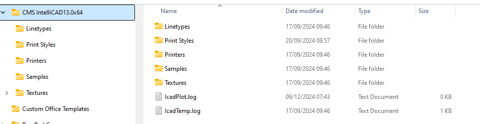

Morning guys,
Here is what I have installed for 13.0.
This is the path C:\Users\username\Documents\CMS IntelliCAD13.0x64
no backup folder.png (25.02 KiB) Viewed 19641 times
ATM all is working OK

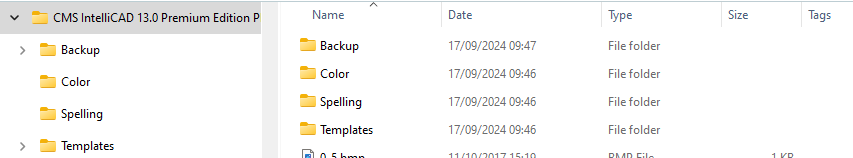

There is a backup folder:
Located here: C:\Users\Username\AppData\Roaming\CMS\CMS IntelliCAD 13.0 Premium Edition Plus x64
with backup folder.png (16.67 KiB) Viewed 19641 times
