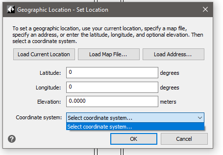

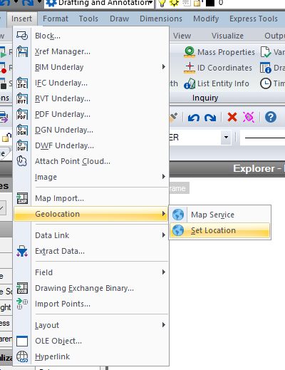

What is your IntelliCAD release please? You can use the tools in IntelliVAD v13 in :
In this menu :
In blue set the location system to EPSG of your choice where you live (5th colonm) !
And then setup lattitude and longitude and Voilà!
