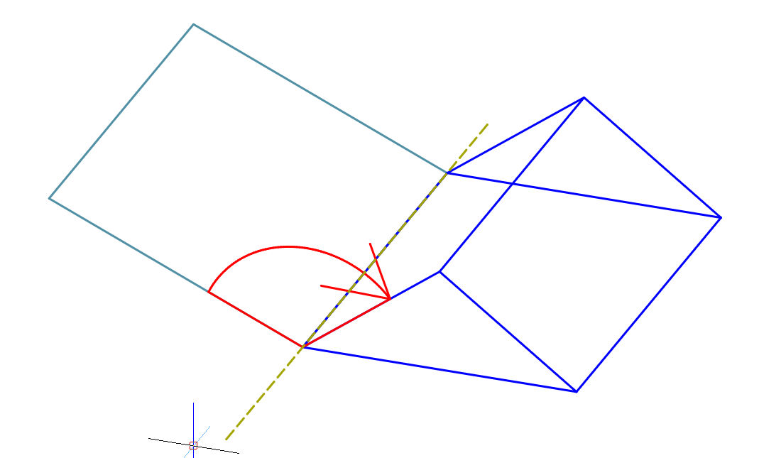

While I am proficient in AutoCAD, I am new to IntelliCAD. The transition from 2D was smooth, but I am encountering challenges with 3D.
Can anybody help me with ROTATE3d command?
rotate3d
rotate3d
I am seeking assistance with the ROTATE3D command. My goal is to rotate the plane to align with the roof plane, as depicted in the attached image, using the "REFERENCE ANGLE" option. Unfortunately, the process is not yielding the expected results.
Could anyone assist me with the following queries?
- offered "Reference Angle" is 0 - what should I click?
- what does "second point" stand for?
- what does "new angle" stand for?
I appreciate any guidance you can provide.

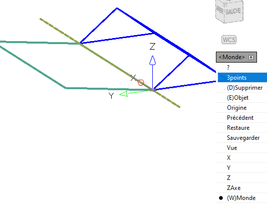

Hi Aleksandra,
You are welcomme. I am Patrick and I will explain you with my few knowledge of IntellCAD'3D:
In fact it's easy you must use the working plan XY. This plan is the base of 3D.
When, you start IntelliCAD your XY plan is your 2D workinn plan as the top view.
But when you willl work in 3D you must change your working plan and all becomme easy as rotate command in 2D.
So with your example you must change your XY plan perpendiculare to the rotation axe like that;
Use the new UCS and choose with 3 points:
And then chose the first point where you want to install your UCS :
Re: ROTATE3D command
Like you see the XY is now the perpendiculare plan to the rotation axe.

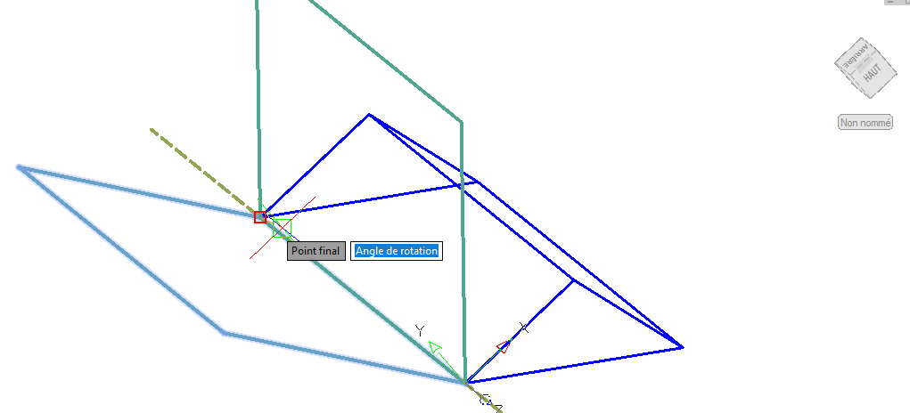

Now if you click on "Haut" in my picture or "Top" in english.
You view change in front of your your rotation axe. It's easy, no?
So if you want rotate your green plan, select it and use the 2D rotate fonction and use the option "Base angle".
Choose the point of rotation and then "Base angle" and select the point of rotation as first and the extremity of your green plan as second.
Then chose the target of the second point and Voilà !
Of course you must change UCS to the world after your rotation.

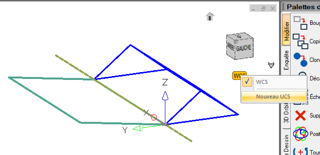

Alexandra there are a second method without UCS when your rotation axe is parallel to the World XYZ, use the 3D positioner :
But stay open the menu and select the red circle to rotate.
This method work but no precise !

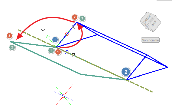

BUT I succeeded I found the solution :
I thought about the problem of snapping to points and I understood that it was the XY plane of the reference frame that worked.
So the solution is to create a UCS reference frame by placing its origin on the rotation point.
Then we use the 3D rotation in the new UCS and then we choose the reference on the line starting on the rotation point of our green plane and for the 3rd point the target point. And the rotation is done correctly :
Warning: The firts point of the axe of rotation define the plan XY where the snapping of point is defined.
The point sectected here is where the perpendicualre plan of snapping is activated !

First: creation of the new UCS :
1 : Order for UCS in red !
2nd : Definition of the rotation axe with the 3D rotation command:
2 : Order for rotation axe in bleu !
3st: creation of the reference angle with the reference parameter :
3 : Order for Reference of angle in green !
