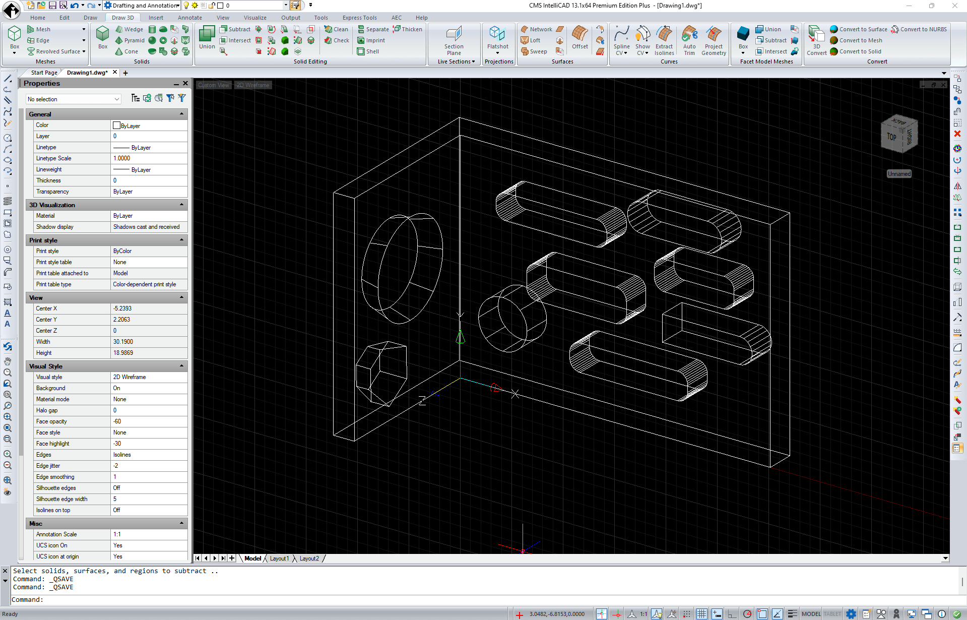

Created a 3D solid mounting plate, subtracted solid cylinders for holes.
The holes do not show on the GA !!!
Close Icad, restart, open mounting plate, holes gone, just 2 vertical lines per hole showing where ther were intended.

The problem is random, it will work for a while then throw in an error.
I have only noticed this on subtracting cylinders.

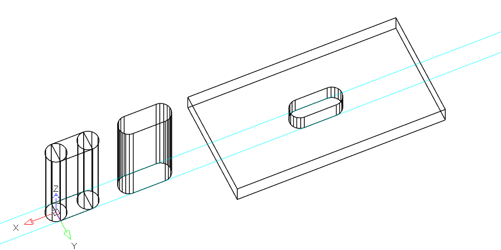

In the image I posted, the oblongs started as a cuboid + cylinder at each end which were joined (union) to form the oblong shape. This was then subtracted fron the parent solid to form the slotted hole.

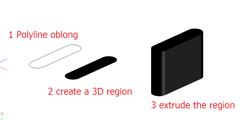

Why don't use :
1 - a polyline of oblong hole
2 - extrude it then in 3D object?
or
2 transform it in surface
and
3 - extrude it then in 3D object.

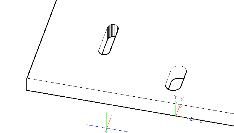

EDIT ; I tested with 2 cubes > addition 3D object work
but substraction 3D object don't work !
Here is the function ^C^C^C_subtract don't work
I have this traceback: Modeler operation error: At least two coplanar solid bodies, surfaces, or regions must be selected
but I use 2 3D cubes only !!!!
But I use two 3d onject : cubes !!!!
_intersect work fine but _subtract don't work !!!
FMintersection work but FMsubstraction don't work
HERE is a video of the substraction operation : https://www.dropbox.com/scl/fi/o9ova7xq ... 2t5in&dl=0
HAAAA OKKKK I understand NOW you must select the substraction operation, then click on the first object + enter and then select the object you want substract ! EUREKA
