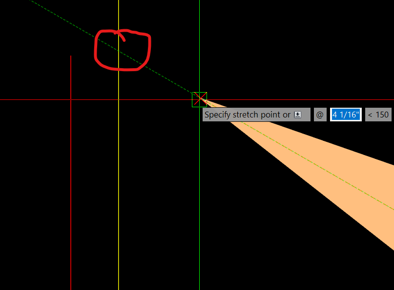

I need entities to snap to the intersection of the polar tracking line and an element. How can I enable this? See attached for clarification. I need a snap at the intersection of the yellow vertical line and the polar tracking (green dashed) line.

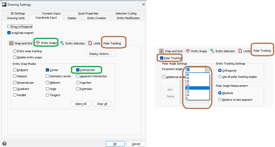

Hi Kelly,
Run the "OS" command to call the "Drawing Settings" dialog:
- at "Entity Snaps" tab, pick to "Intersection" option
- at "Polar Tracking" tab, pick to "Polar Tracking" and select/add a Polar angle.
Please refer attached image below for details.
