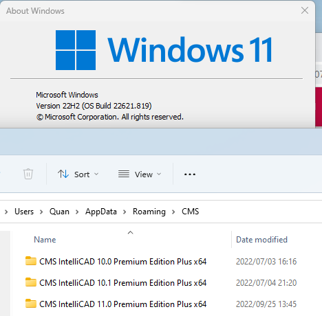

When I go to username/appdata/roaming there is NO CMS folder!
Any idea where it is? as I want to copy over a number of files/folders from my win 10 PC.

Hi Steven.
Here's the CMS folder in my Windows 11.

APPdata is as it should be, I guess I had not restarted or just user error!
