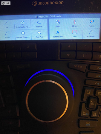

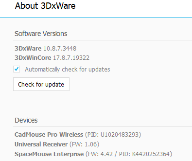

Hi Patrick,
I also have one, it works on IntelliCAD 11.
The drivers
Ps: the latest drivers is 10.8.12

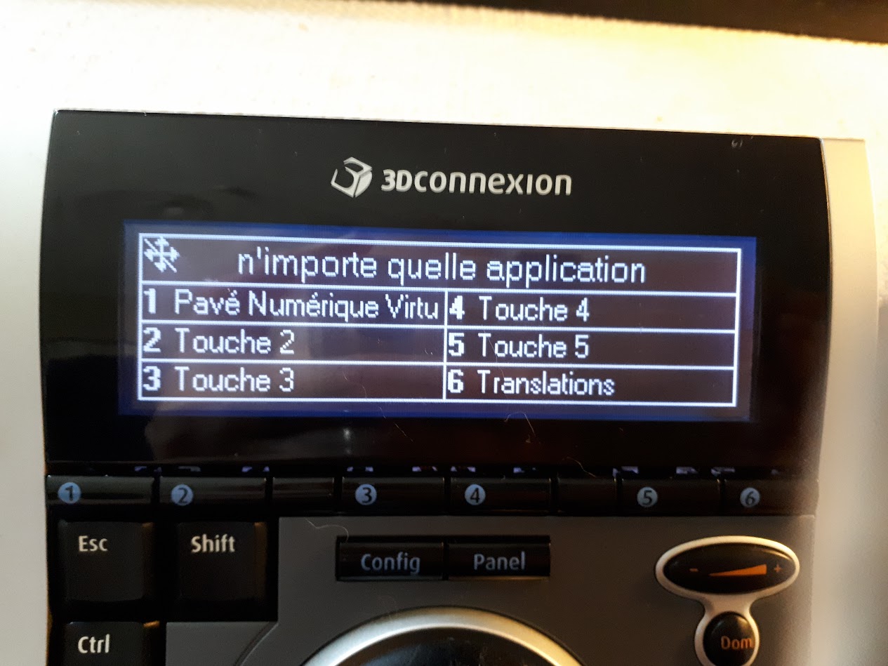

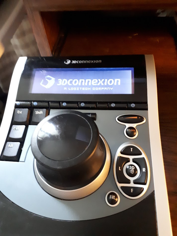

Re: 3DConnexion mouse setup
Posted: Sun Mar 05, 2023 2:12 am
Thks QuanNguyen,
Your answer help me
I installed the last Win10 for SpacePilot 10.4.10 but nothing
I installed the last driver 10.8.12 but nothing
I will try the last update driver 3.16.3......
but I think my SpacePilot is broken...I buy it on Ebay 120 euro but I will return it:
when I connect it to the computer, the screen displays "3Dconnexion" but I can't setup the programming keys : nothing !!!!
I tested the 10.4.7 driver for SpacePilot but the 3Dconnexion softwares don't find it and display
Weird ! I got screwed.....
It works only with Blender, not with SketchUp and IntelliCAD....

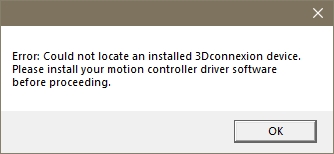

Posted: Sun Mar 05, 2023 3:08 am
Ha with the last update driver 3.16.3 I have changes :
Always nothing with IntelliCAD.

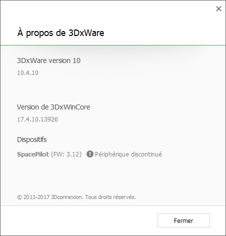

Posted: Tue Mar 07, 2023 4:30 am
The 3DConnexion SpacePilot USB Logitech is a used product (2005) and his driver is v10.4.10.
Today the 3DConnexion version is v10.4.12 but don't work with my SpacePilot

Re: [Resolved] 3DConnexion mouse setup
Posted: Thu Feb 27, 2025 2:21 am
Thanks mariakenneth147 but I found the solution. My Space Pilot 3Dconexion was too old for IntelliCAD.
SN / PID : D11U31XX052600162
My driver for this Space Pilot don't use the new sockets used by the today v10.9.3 that I can't use.
